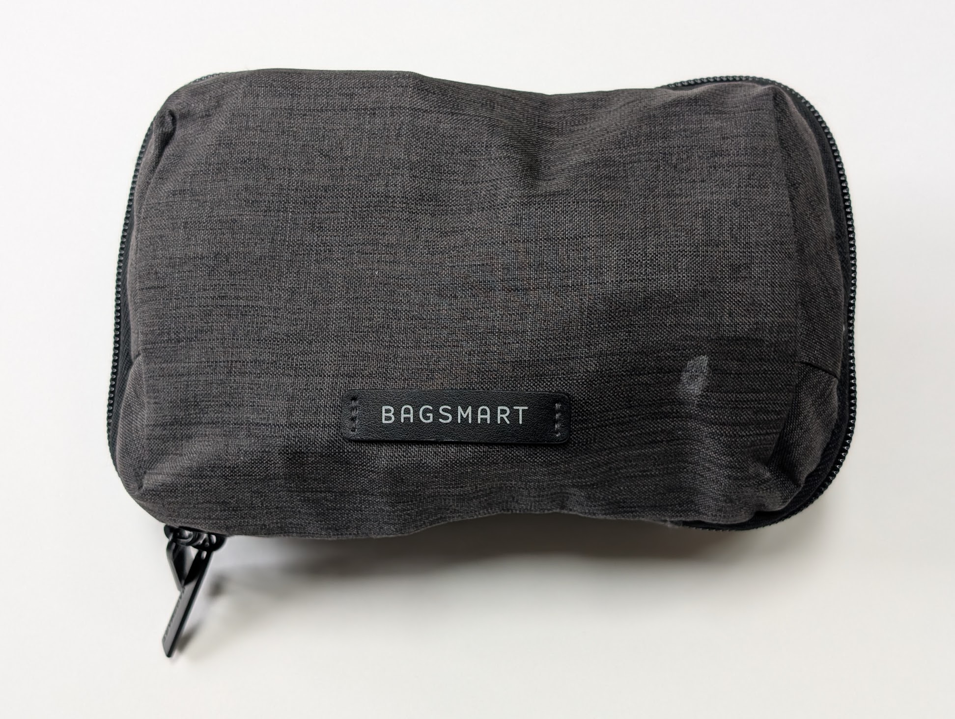

This bag fits in one hand and disappears into my backpack:
bag
I don’t want to afraid to carry it with me in case it is damaged or lost. So I chose relatively inexpensive components:

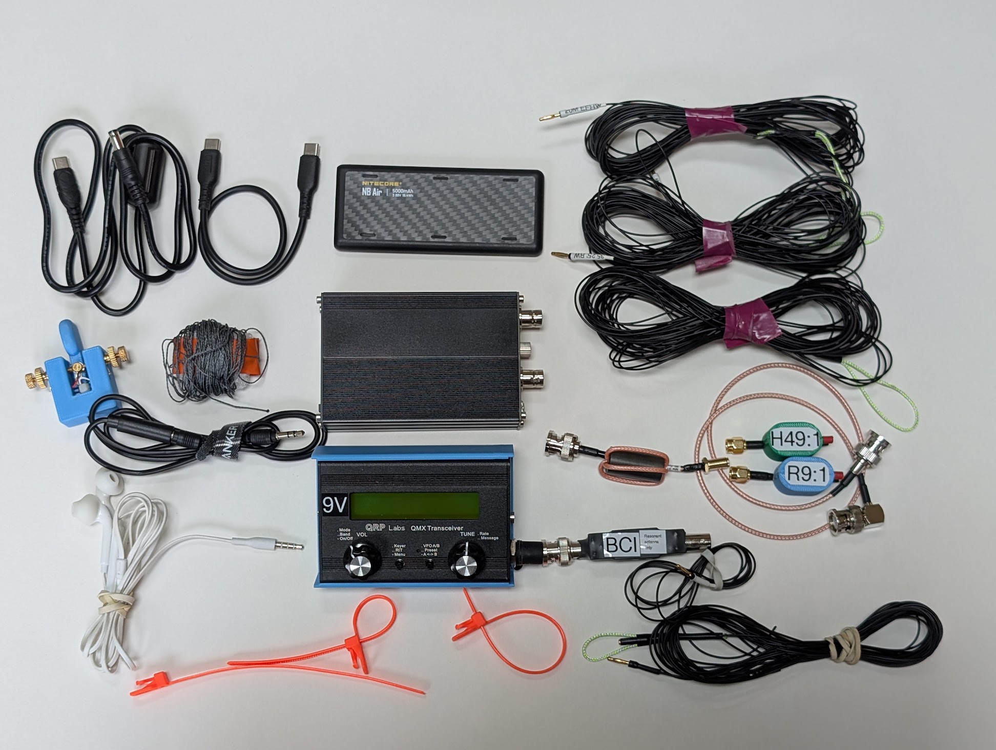

Components
Components
  • Bagsmart bag (components just barely fit)

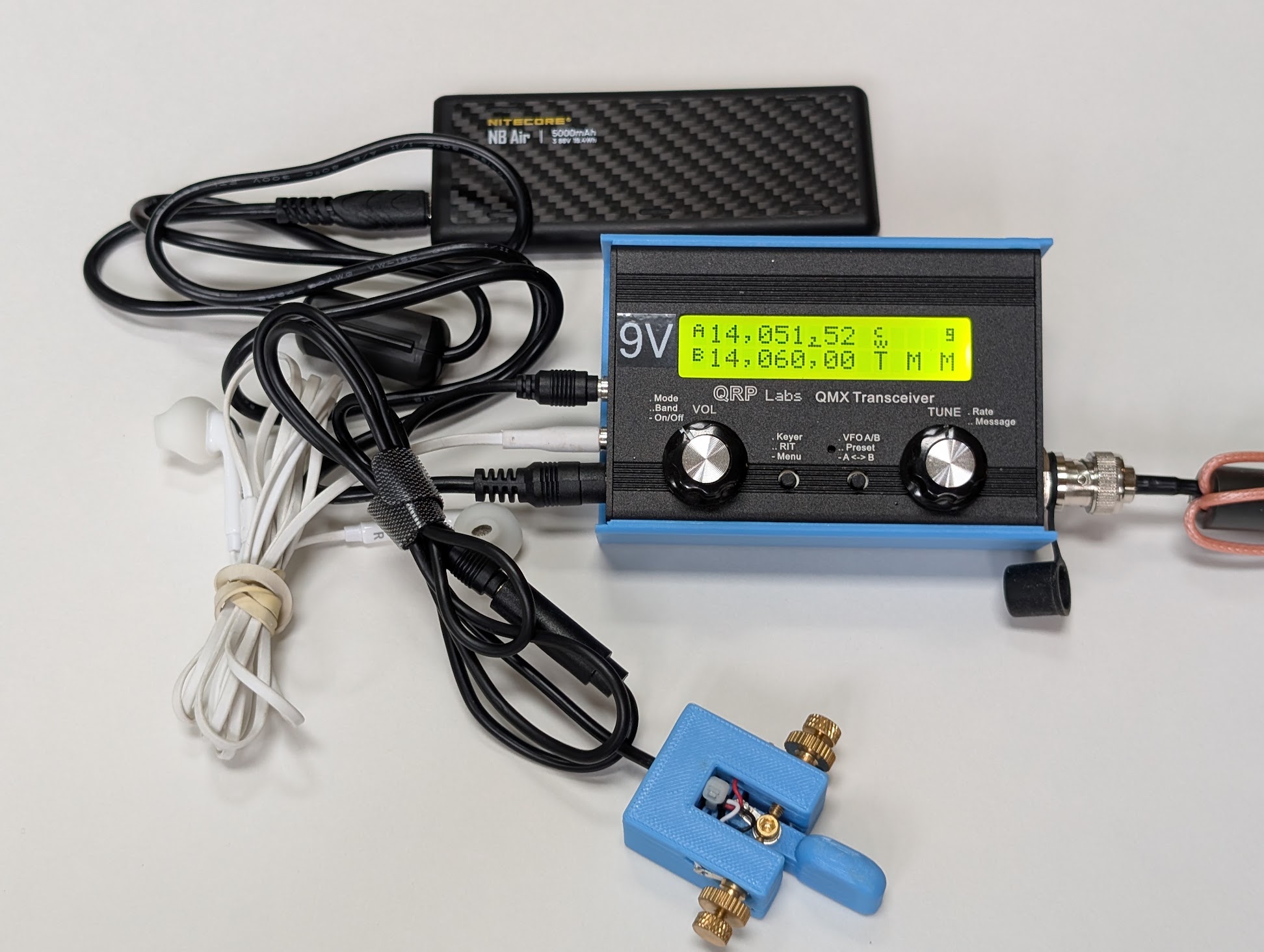

  • Mid-band QMX (60m–15m), built for 9V (voltage not important here)
  • 3D-printed hard case/stand
  • M-15 tuner (lightest ATU-10 variant I’ve found; has only one battery so weighs less), coax jumper (included), and USB-C cable to charge it if necessary (or do digital modes by connecting to a computer)
  • My 3d-printed key, miniaturized (by changing parameters and removing features)
  • K6ARK microphone (so far unused; I like CW)
  • Nitecore NB Air Ultra + 9V trigger cable 9V male trigger module connected to an official QRP Labs barrel plug.
  • 20m EFHW + Mix 43 FT50 49:1 unun in 3d-printed case (design not yet shared, needs some improvements)
  • 2x 35.5’ random wires make 71’ (+20m is 68.5’ or 104’ random wire) for four different lengths + Mix 43 FT50 9:1 unun in 3d-printed case (same unshared design)
  • Short (for 20m EFHW) and long (for random wire) counterpoises
  • 4-turn mix 31 choke made with RG-316 coax
  • K9DP BCI filter which I needed when I didn’t have it and haven’t needed since
  • 2 oz tungsten throw weight wrapped in foam, with graphite-lubricated UHMWPE braided fishing line as throw line
  • My favorite cheap wired earbuds
  • Reusable cable ties and electrical tape for holding things together as needed

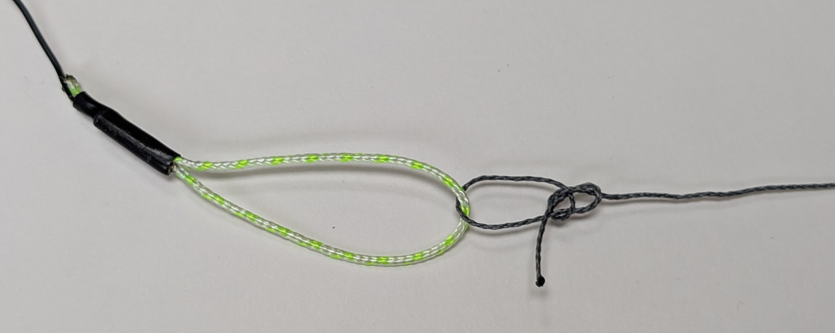

All the antenna wires use 2mm bullet connectors, and except for the short counterpoise, they all have a male connector on one end and a female connector on the other end so that they can be assembled end-to-end. Also, on the female end, they have loops of dacron twine to connect them to the throw line, and when connected in series to make a longer antenna, to each other. I use electrical tape to bundle the wires (wrapped in a figure-8 to avoid twisting) when I put it away, and the same electrical tape holds the twine from one wire to the plug on the next wire, so that it doesn’t come apart when deployed.
loop
Except for the strain reliefs (not used here for plain end-fed wires), this is the technique I document in Avoid Alligators: Always add links, not knots which weaken wire.

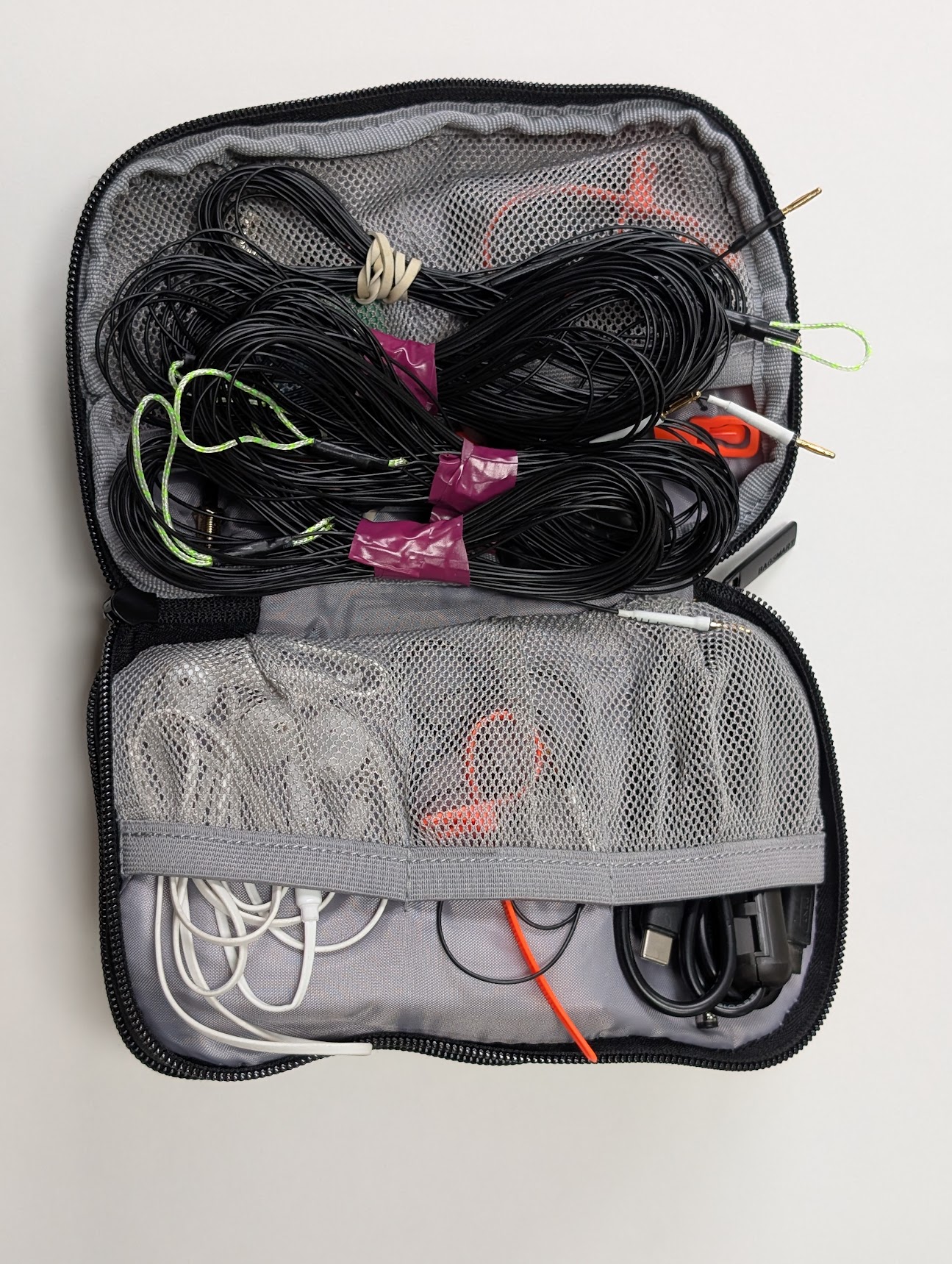

The top compartment is busy with most of the bits and bobs; the antenna wires are just stuffed in.

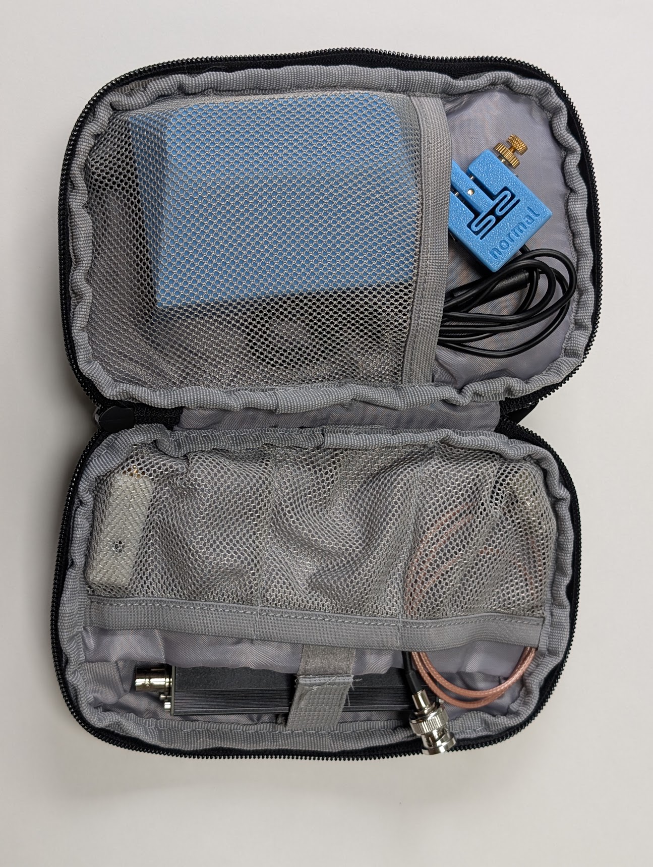

The bottom compartment holds the radio, key, tuner, coax jumper, and a few small items of overflow from the over-filled top compartment.
